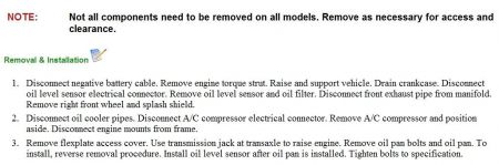

I have a stripped out oil plug and a leaking gasket. I want to know step by step how to change the oil pan, and if it's too big a job for a guy with hand tools and a floor jack.

https://images.2carpros.com/forum/automotive_pictures/261618_Noname_2765.jpg
