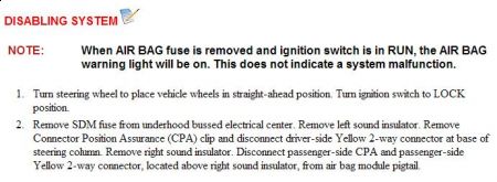

i would like to disable the air bag system without it going off.i heard you can pull the fuse out.is that true if so where is the fuses located?

It is not recommended to operate the vehicle with the SRS deactivated.. Deactivation of the SRS should only be used when performing repairs to the vehicle where an activated SRS would be a potentional danger for the mechanic..
https://images.2carpros.com/forum/automotive_pictures/261618_Noname_1067.jpg
