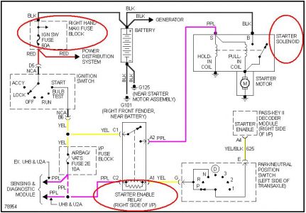

1996 Buick Park Avenue second starting solinoid
1996 BUICK PARK AVENUE
WORLDCHIEF69
Engine Mechanical problem
1996 Buick Park Avenue 6 cyl Front Wheel Drive
Where is the second solinoid located? I changed the starter and was told there was a second!
Feb 22, 2009 at 1:55 AM
ZACKMAN
  • 4,202 POSTS
Nope. Whomever told you was mistaken. You have a maxi fuse 60A, starter relay in the fuse box, and the starter solenoid attached to the starter assembly.
