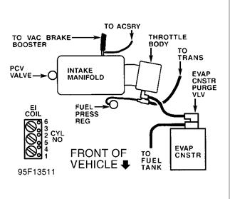

i'd like a guide for the fuel pressure regulator vacume line.I need to replace the vacume line and can't seem to be able to find where the old existing line was ran.plz help

Hi, found this info for v6--vin K.
https://images.2carpros.com/forum/automotive_pictures/170934_vacuum_diagram_v6_vin_K_1.jpg
