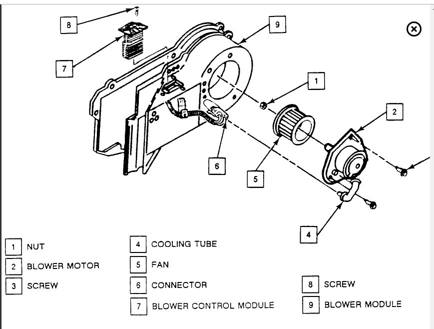

SATURNTECH9
  • 30,869 POSTS
On the center rear of the engine compartment you will find the blower control module.It has a purple wire gray wire with a black stripe a black wire and red wire.Unolug it and see if the blower motor shuts off?Also a multi meter would be great to test some things.
Aug 19, 2019 at 11:34 AM (Merged)
BRAD1234
My heater fan stays on high speed even when the ignition is off and key removed. I think it is the blower motor resistor/module that has failed. Can you tell me if this is true and if so how to get to the module?
  • 75,992 POSTS
Inspect and test the blower motor control module at center rear of engine compartment
  • 75,992 POSTS
I gave you for an Auto HVAC system Park Avenue and Ultra
https://images.2carpros.com/forum/automotive_pictures/12900_hvac_5.jpg
  • 75,992 POSTS
https://images.2carpros.com/forum/automotive_pictures/12900_blower_motor_control_module_2.jpg
