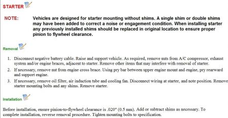

1994 Buick Park Avenue starter removal
1994 BUICK PARK AVENUE
154,000 MILES • 6 CYL • 2WD • AUTOMATIC
PATRICKBD
I have the wires disconnected but do not know how to get accsess to startermounting bolts.
