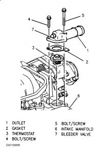

1994 Buick Park Avenue how replace thermstat
OLIVER JONES
  • 1994 BUICK PARK AVENUE
Heater problem
1994 Buick Park Avenue 6 cyl Two Wheel Drive Automatic
How to change a thromstat?
Monday, April 13th, 2009 AT 11:54 AM
BLUELIGHTNIN6
  • 16,542 POSTS
REMOVAL:
Drain coolant until it is below level of the thermostat.
Remove the coolant outlet assembly (1).
Remove thermostat (3).
https://www.2carpros.com/forum/automotive_pictures/261618_1_40.jpg
INSTALLATION:
For installation, reverse the removal procedure. All engines use a gasket O-ring (2). The thermostat, coolant outlet (1), is sealed with a gasket.
