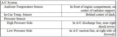

A/C cools great. When using, compressor
makes clicking sound. Compressor is clicking
"off & on" continually when using A/C.
I can see compressor engaging "off & on".
I also have same problem when using heater.
Great heat. But compressor is engaging.
"off & on". Do I have a switch problem?
Tuesday, March 10th, 2009 AT 12:41 PM
ZACKMAN
  • 4,202 POSTS
Either you don't have enough refrigerant, or one of the switches is bad
https://www.2carpros.com/forum/automotive_pictures/55316_94parkaveac_1.jpg
