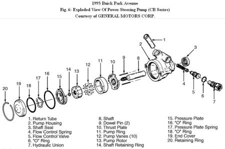

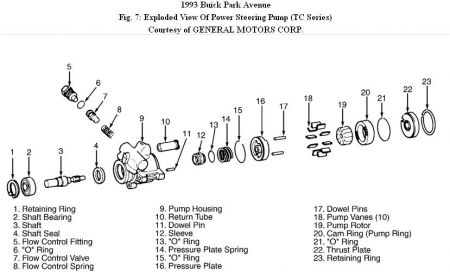

i need to know how to remove the pulley off the power steering pump also would like to have a diagram of the inter making of the pump thk you

Hi royal height, The pulley center is left threaded and recommended removal procedure requires a special tool to hold the pulley. An impact wrench would be an easier option. There are 2 different types of pump and here are the explaoded views.
https://images.2carpros.com/forum/automotive_pictures/192750_PSPump93PArkAvenueFig06_1.jpg
https://images.2carpros.com/forum/automotive_pictures/192750_PSPump93PArkAvenueFig07_1.jpg
