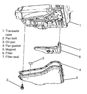

there is a metal ring that goes on the end of the filter. Do I insert this first, then put the filter in or do i put it on the filter then install? How do i get it to go in is there a trick?

Install a new transaxle filter and O-ring seal, locating the filter against the dipstick stop
https://images.2carpros.com/forum/automotive_pictures/261618_0900c1528004a6b3_1.jpg
