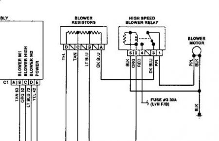

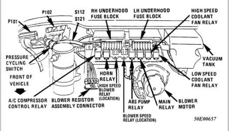

Blower motor was bad,(frozen) after replacement
found no power. checked all fuse and wiring,everything looks good.Checked with a elec meter, Need a wiring schematic to find blower relay?
Feb 7, 2010 at 9:06 AM
JDL
  • CAR REPAIR CONTRIBUTOR
  • 16,098 POSTS
Welcome to the forum. Thanks for the donation. With relay energized, only high speed has continuity.
