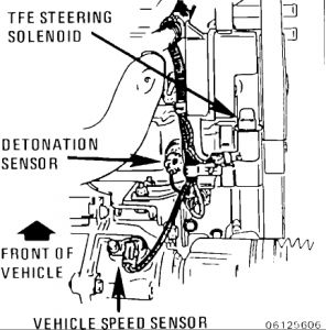

Where is the knock sensor located on my car 3.8 supercharged

Vehicle Speed And Knock Sensors
LOCATION FROM TOP TFE Steering Solenoid Detonation (Knock) Sensor Vehicle Speed Sensor https://www.2carpros.com/kpages/auto_repair_manuals_alldata.htm
