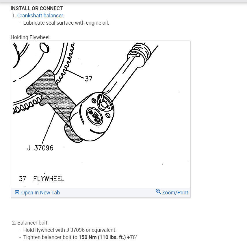

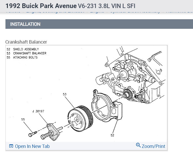

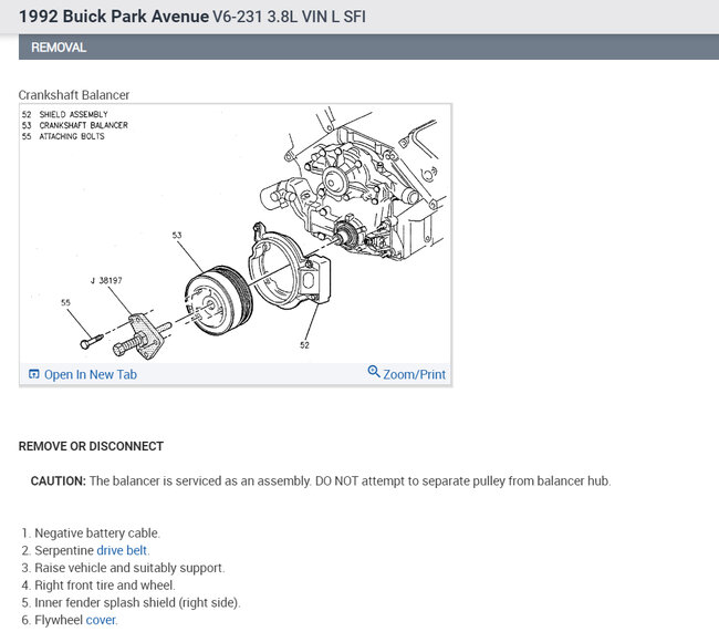

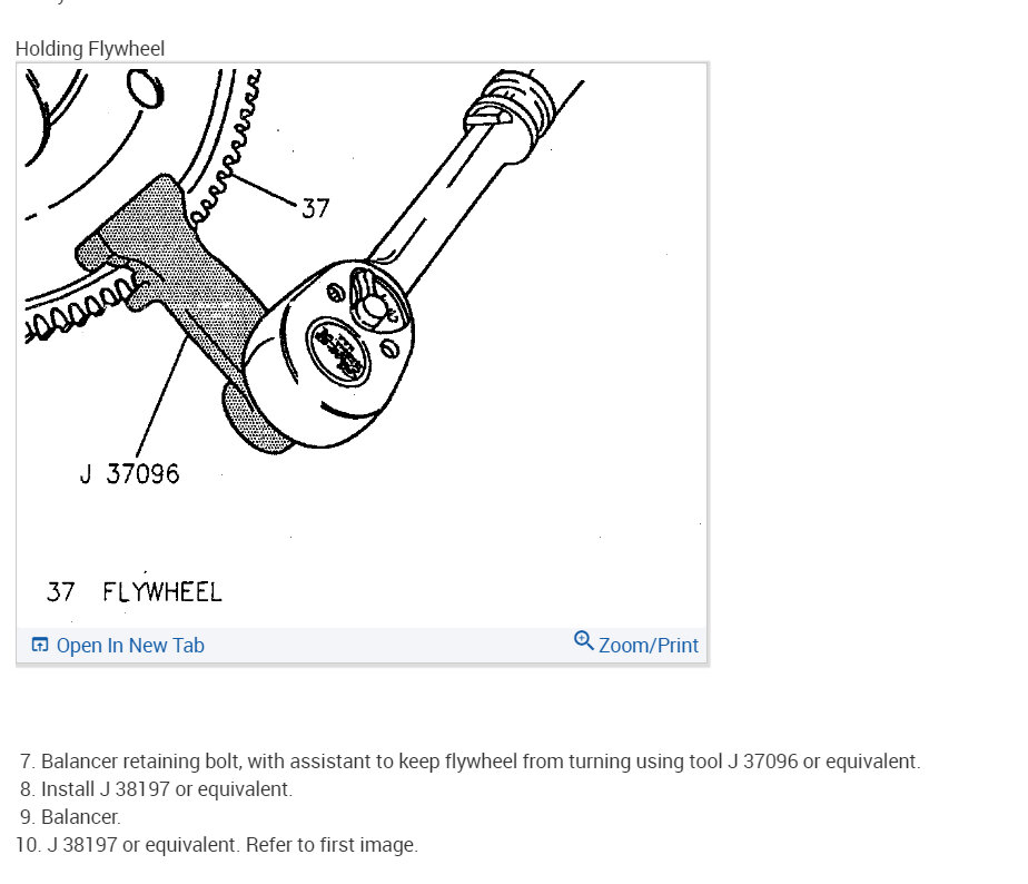

I am curious as to what the failure is, was there slippage or some visually obvious failure that was the cause of the noise? I am trying to understand the root cause of this failure. Check out the images (Below). Please let us know what happens.
