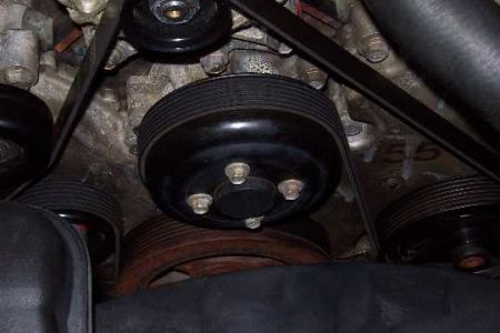

We have discovered that the water pump ;ulley is loose can it be fixed independantly or do we need to replace the whole water pump? The surpentine belt is slipping badly as a result of the wobble in the pulley. If we need to replace water pump, how is this done. Thank you

The pulley is attached to the pump via 4 bolts. Just tighten the bolts and you are fine. This is not engine, but you get the picture.
https://images.2carpros.com/forum/automotive_pictures/55316_pumppulleybolts2_1.jpg
