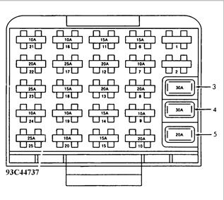

I'd have to be sure, the battery connections are good on both ends. Then I'd check the fuse box, use testlite, check for voltage, circuit breaker number 4-- 30 amp, should be hot all the time. Circuit breaker 3 and 4, may be the same, you can look, swap them if they're the same. If no voltage on that circuit, I haven't found enough info to track the circuit?
https://images.2carpros.com/forum/automotive_pictures/170934_park_avunue_fuse_box_1.jpg

I checked current to all the fuses/circuit breakers and it all looked normal some of them were always on. This is the weirdest electrical issue I have ever had with any car. This must be a GM thing?
