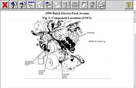

Where is the Cam sensor on my car 1990 park avenue
Oct 2, 2007 at 10:01 AM
Experienced Mechanic
75,988 POSTS
Bottom will help you find it
