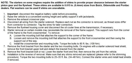

Starter Replacement
Sunday, May 16th, 2010 AT 12:37 PM
INTERNETMECHANIC
MECHANIC
700 POSTS
My info showed this.
On some makes and models it may be necessary to remove flywheel dust cover.
