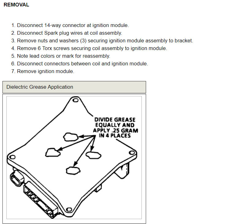

am at my end with this car... was driving one day and car just cuts out.. thought i was outta gas, toasted the battery trying to crank it. tried to jump it and after that it wouldn't kick over, its getting fuel for sure just no spark. iv changed the cam position sensor, crank position sensor, and tested the 14 pin connector to the ignition module and all is well there. the guy that jumped my car might of crossed the jumper cables.. someone told me that it could of fried the computer.... need a little help please..and a prayer lol thank u

There is an ignition module that goes out on theses cars which sounds like what it happening to your car as well.
Here is a diagrams to help you change the module out.
