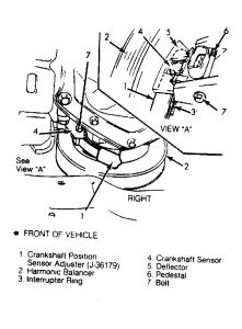

On a 1988 Buick LeSabre automatic with 165944 odometer miles, what is the air gap on the crankshaft sensor?
Check engine light is on and it was replaced about one year ago.

I will look but will probably need engine size? Also what model? Yes there was front and rear drive.. I come up with 0.25 on either side of the interupter ring...But it requires a special tool...
