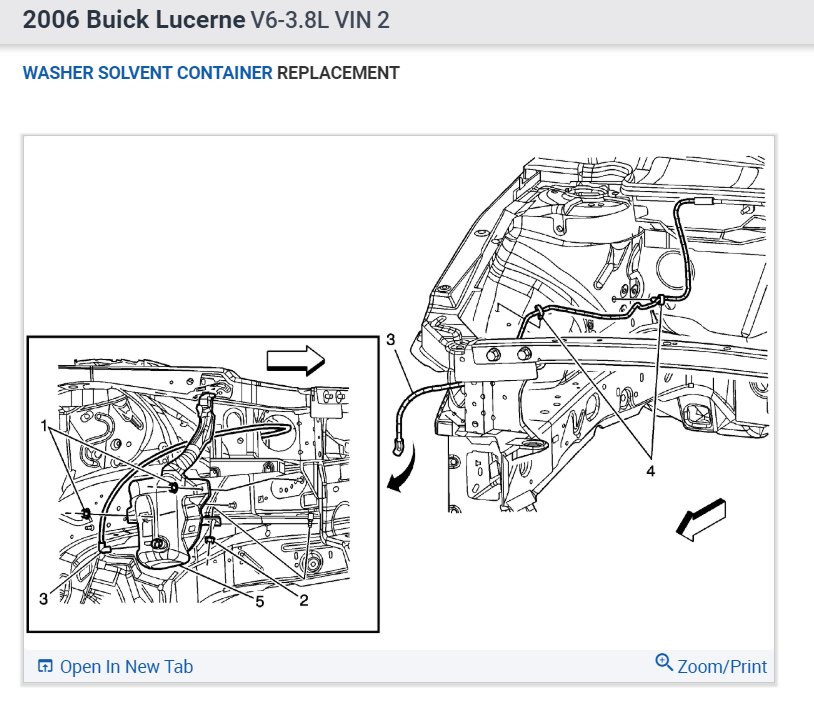

Where is the windshield washer fluid pump located at? It was working on and off, now does not work at all. No sound or anything. We are assuming it is the pump? Thanks for any info.
Tuesday, December 1st, 2009 AT 8:24 AM
  • 109,747 POSTS

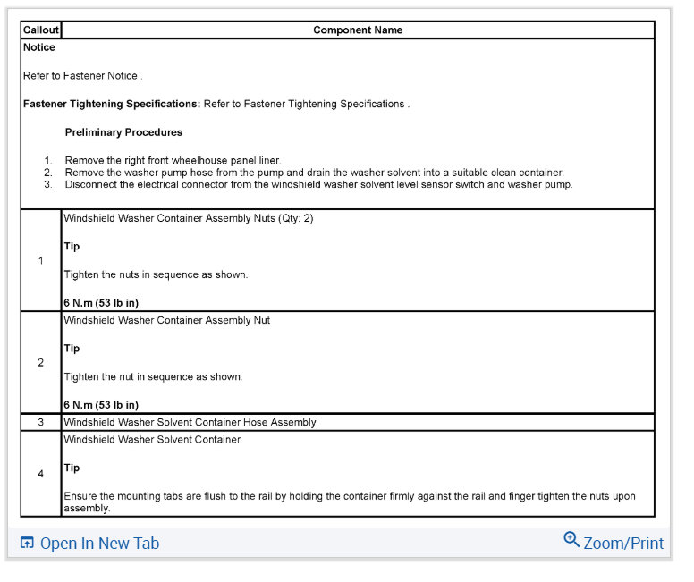

The washer motor is at the bottom of the W/S washer tank here is a guide to walk you through the steps of changing it and diagrams below to show you on your car.
https://www.2carpros.com/articles/how-to-replace-a-windshield-washer-pump
