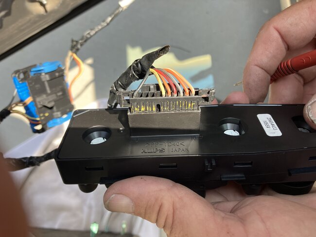

Do you have a full wiring diagram for 2001 Buick lesabre custom? My dws has 7 wires per photo attached.

So some of those wiring are for the locking system and the other for the windows. Here is the window switch wiring diagrams as well to help you see how the system works. If you are talking about the 30 amp circuit breaker for the windows then that can be a problem with the DDM which it feeds. Check out the images (below). Please let us know what happens.
