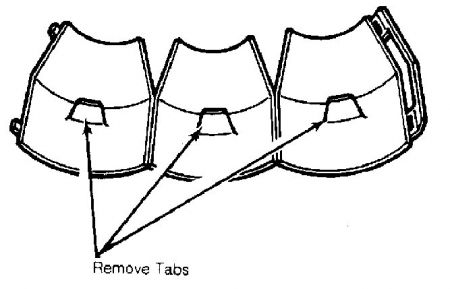

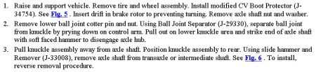

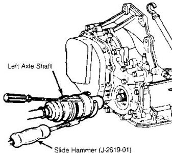

1990 buick lesabre 3.8 litre engine i need to replace the drivers side cv halve shaft. what is involved? what tools do i need? i got a price of 180.00 for a mechanic to do it, the part is 65.00 i would rather do it myself to save some $$$$

https://images.2carpros.com/forum/automotive_pictures/30961_axle_1.jpg
https://images.2carpros.com/forum/automotive_pictures/30961_fig5_1.jpg
https://images.2carpros.com/forum/automotive_pictures/30961_fig6_1.jpg
