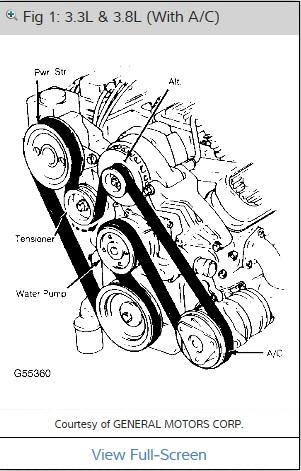

How do I replace the serpintine belt. I need a diagram.

My info showed this for the 3.8L engine, belt routing. You have to use a wrench or rachet on the tensioner, pull the tensioner to release tension on belt.
