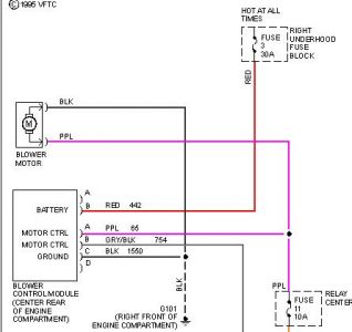

1995 buick lesabre 3.8l vin(L) THE BLOWER WILL NOT SHUT OFF EVEN WITH KEY OUT. HAS 12 V TO RESISTOR AT ALL TIMES KILLING BATTERY UNLESS I DISCONNECT THE PLUG TO BLOWER. I HAVE TRIED TO LOCATE ALL RELAYS AND DISCONNECT ONE AT A TIME (UNDER HOOD ON FIRE WALL AND ALSO IN RIGHT KICK PANEL. I NEED HELP PLEASE. THANKS IT HAS ATC HEAD

RED WIRE IN RELAY AS IN DIAGRAM SHOULD HAVE 12V
https://images.2carpros.com/forum/automotive_pictures/59481_Noname_4.jpg
Mar 4, 2007 at 6:04 AM

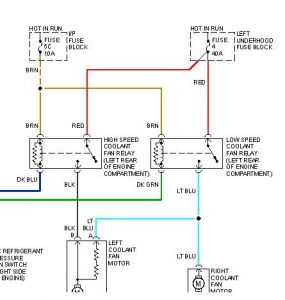

WAIT ON AUTO AC IT IS HOT AT ALL TIMES SORRY HAD MANUAL AC CHECK THIS OUT
https://images.2carpros.com/forum/automotive_pictures/59481_Noname_6.jpg
Mar 4, 2007 at 6:32 AM

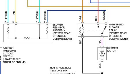

HERE IS THE OTHER SIDE WITH THE INFO THAT PERTAINS TO THE SYSTEM YOU SHOULD BE ABLE TO SAVE THESE FILES AND OPEN THEM IN YOUR PICTURE VIEWER , THEY ARE JPEG
https://images.2carpros.com/forum/automotive_pictures/59481_Noname_7.jpg
Mar 4, 2007 at 6:49 AM

hey jim last question of the day. i don't have power at the purple wire fuse #11 where is the relay cntrl center,is it on rirht side kick panel under dash???. like i stated the blower quit working altogether now.and all i did was hit the auto switch!!! thanks again
