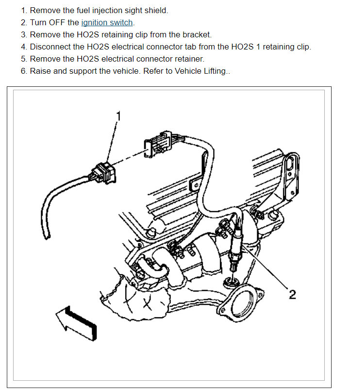

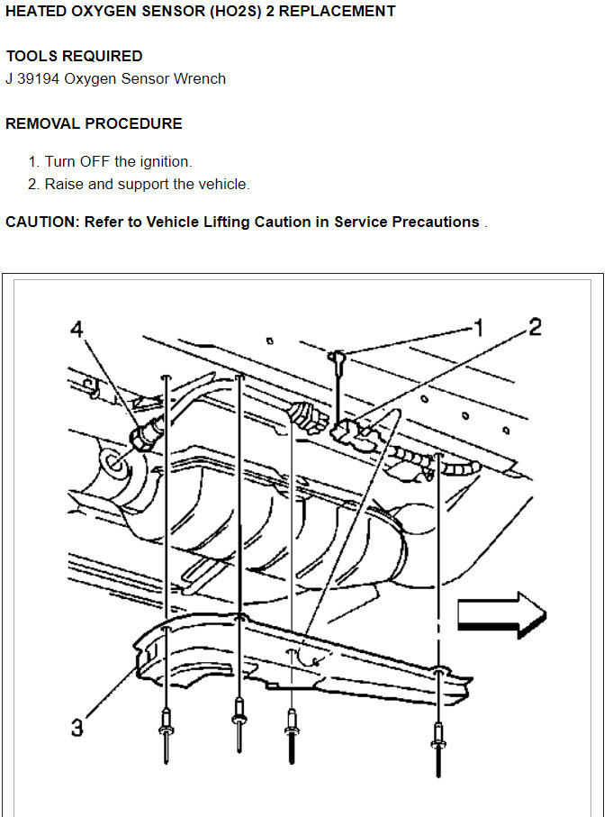

Can anyone tell me the location of the O2 Sensor that the computer says is Bank 1 Sensor 1? I just need to make sure I have the right one, thanks!
Jun 21, 2010 at 8:59 AM
  • 55,627 POSTS
The bank 1 sensor 1 is located at the front of the exhaust system in the exhaust manifold. Here is a guide to help you see what you are in for when doing the job.
https://www.2carpros.com/articles/how-to-replace-an-oxygen-sensor
Here is how you test it
https://www.2carpros.com/articles/how-to-test-an-oxygen-sensor-02-sensor

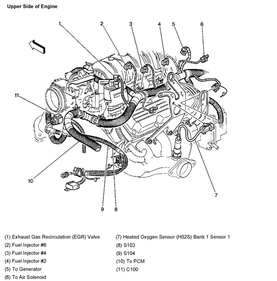

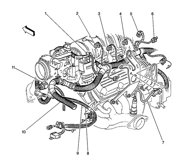

Here are the locations for your car (Below)

Is there any tricks to know when changing the oxygen sensor before the catalytic converter?
Jan 2, 2018 at 11:02 AM (Merged)
  • 55,627 POSTS

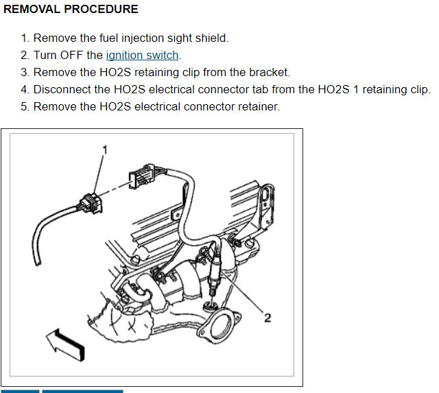

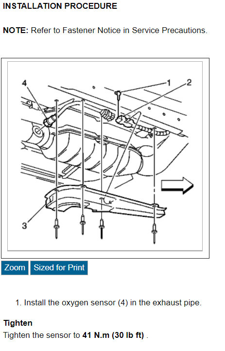

The is no real trick the sensor size is 7/8 you can just use a wrench. Here is a guide to help you see what you are in for when doing the job.
(Here is the locations for your car below)
You might need to raise the car up to do the job.
