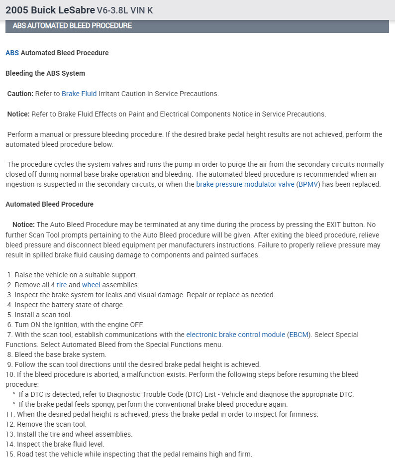

We needed new front rotors, and pads all around. It had a full pedal when the car was not running but pedal sank to floor while applying pressure when car was running. we then assumed an internal leak in master cylinder. We replaced the master cylinder with no improvement. We were told that it was the ABS computer module, we replaced that too, no improvement. What can cause this? we bled brakes three times, no air! Can it be a sensor or what? Asked a local GM mechanic, and he has not come across this one yet! Need help! Thanks, Calfman

You might have to bleed the brake system again. As this vehicle with ABS requires a special brake bleeding procedure with a scan tool to communicate with the ABS module.
Without the tool it will not bleed properly and will have braking issues.
Here is a helpful video on how to bleed ABS:
https://youtu.be/nQRnKyVyMuQ
https://www.2carpros.com/articles/how-to-bleed-or-flush-a-car-brake-system
I have attached the step-by-step instructions for the ABS bleeding below.
