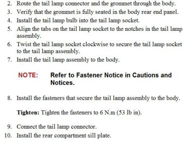

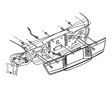

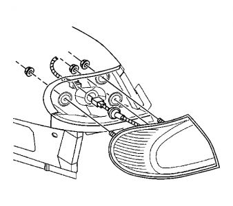

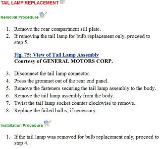

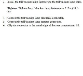

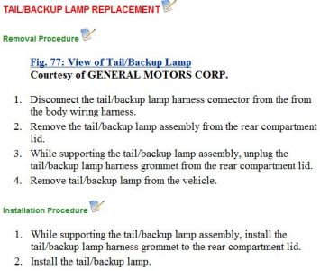

how do you get to the tail lights one is burnt out and I cant figure out how to change it

https://images.2carpros.com/forum/automotive_pictures/55316_04lesabretail_1.jpg
https://images.2carpros.com/forum/automotive_pictures/55316_04lesabretail_2.jpg
https://images.2carpros.com/forum/automotive_pictures/55316_04lesabretail2_1.jpg
https://images.2carpros.com/forum/automotive_pictures/55316_04lesabretail3_1.jpg
https://images.2carpros.com/forum/automotive_pictures/55316_04lesabretail2_2.jpg
https://images.2carpros.com/forum/automotive_pictures/55316_04lesabretail4_1.jpg
Apr 8, 2009 at 11:32 PM
