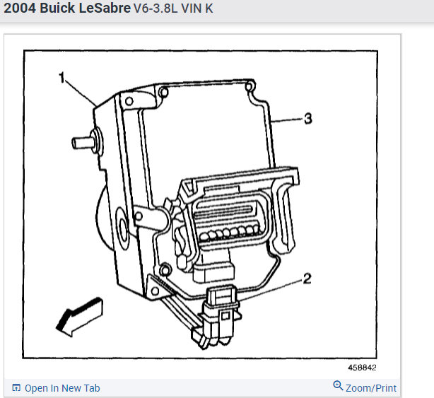

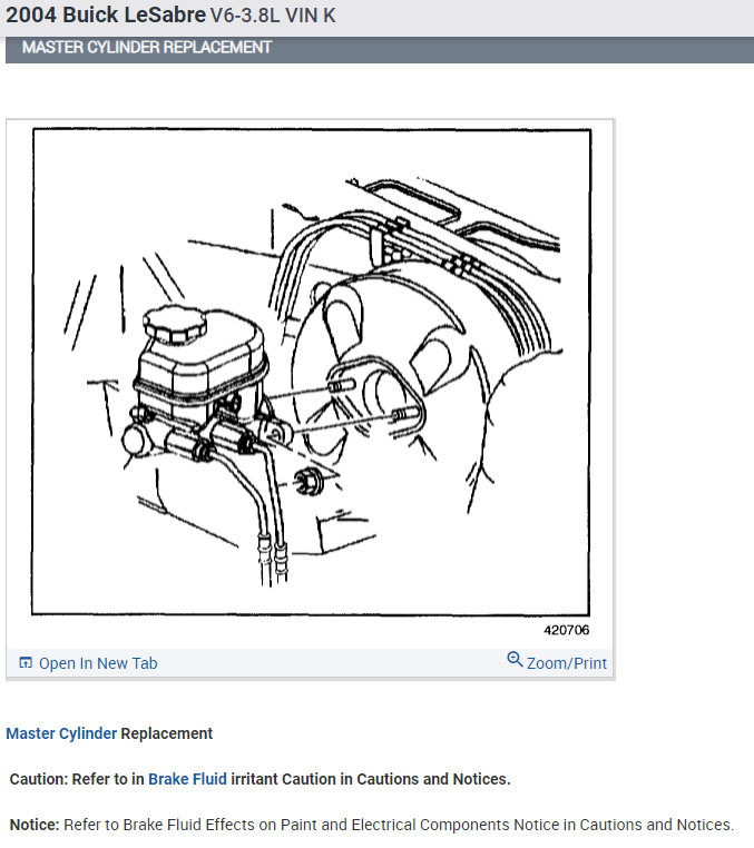

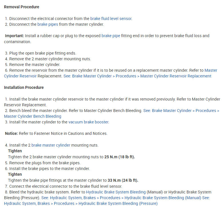

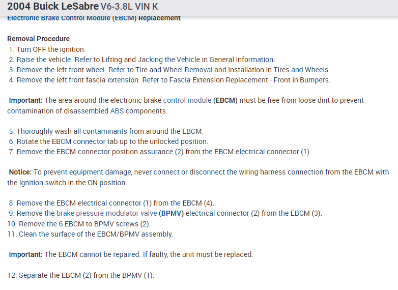

master cylinder What should be the price to replace? I was charged $462. That did not fix the leak. Now they want $700 to replace the "valve under the master cylinder" And $800 to replace "an electric box" damaged by the leaking fluid. What are reasonable charges for each of these three (3) replacements?
Dec 6, 2007 at 9:56 PM
SQM
  • 6,383 POSTS

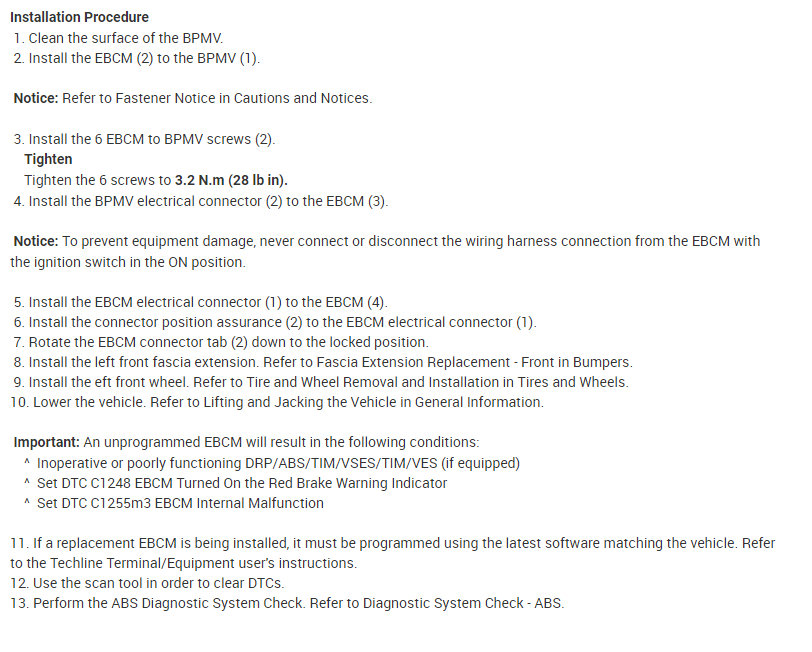

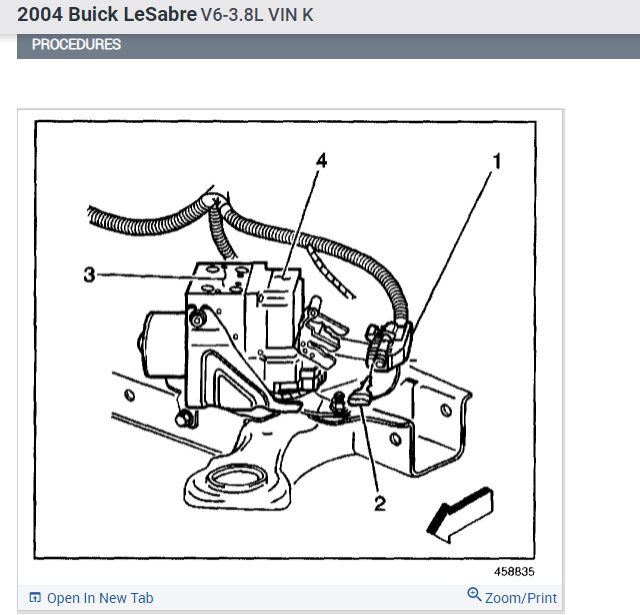

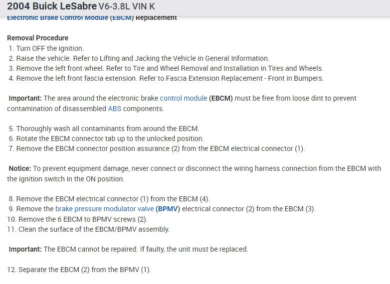

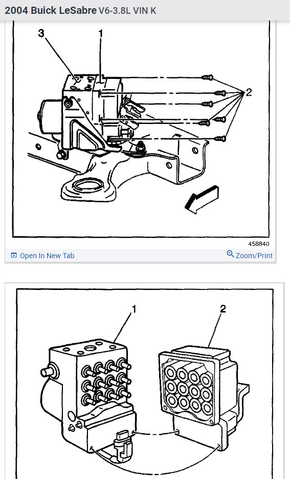

It sounds like they are talking about replacing the electronic brake control module (EBCM).
That control module can run anywhere from $200.00 to $300.00.
Do keep in mind the shop always quotes with the labor price included.
Which can vary from shop to shop as they all have different labor rate.
https://www.2carpros.com/articles/how-to-replace-a-brake-master-cylinder
https://www.2carpros.com/articles/how-to-bleed-or-flush-a-car-brake-system
I have attached the replacement procedures for your reference.
