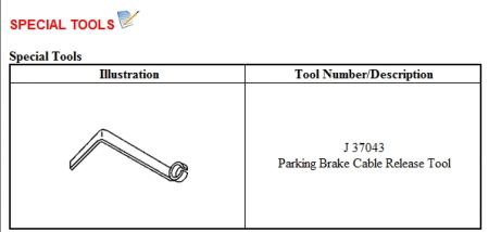

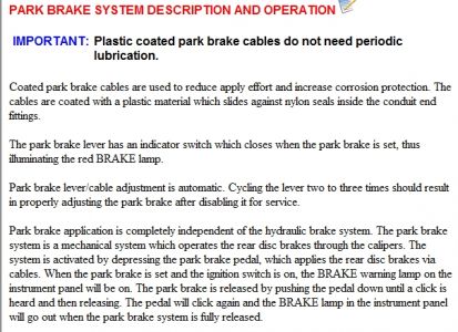

What kind of set-up does this car have for emergency brake. In changing rear pads do I need a special tool?
Wednesday, July 14th, 2010 AT 4:40 PM
BLUELIGHTNIN6
MECHANIC
16,542 POSTS
No special tools required for the regular rear pads..
