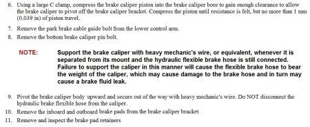

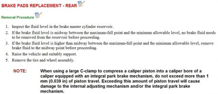

2004 Buick Lesabre rear brake pad removal
2004 BUICK LESABRE
115,000 MILES • 6 CYL • FWD • AUTOMATIC
JFMOORE5430
I replaced these pads 2years ago and can't remember how I removed the old ones. can you help?
Oct 31, 2010 at 7:20 AM
BLUELIGHTNIN6
  • 16,542 POSTS
https://images.2carpros.com/forum/automotive_pictures/261618_Noname_2861.jpg
https://images.2carpros.com/forum/automotive_pictures/261618_Noname2_939.jpg
Oct 31, 2010 at 9:05 AM
