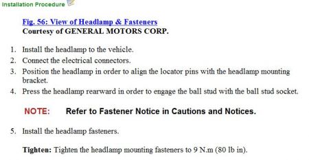

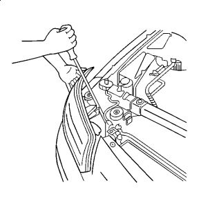

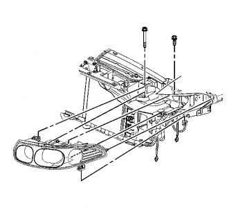

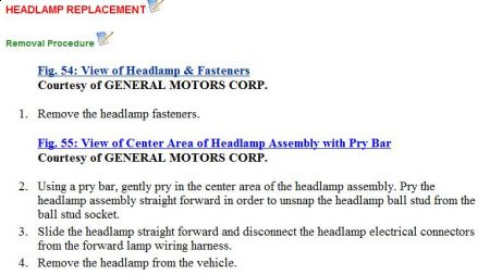

You have to remove the entire headlamp assembly out. Direction is similar for both sides.
