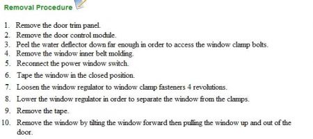

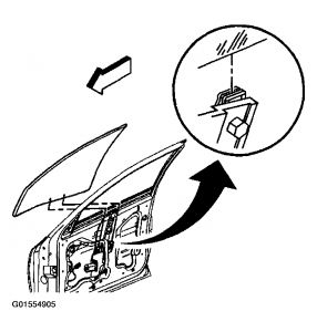

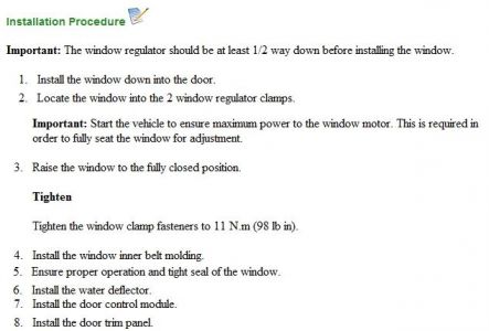

What is involve with replacing the fron passenger window glass?
Jul 14, 2010 at 11:40 AM
BLUELIGHTNIN6
  • 16,542 POSTS
Hello and thanks for donating Below are the proper replacement steps for your vehicle's front passenger window. If you need further details on this procedure feel free to ask me..
