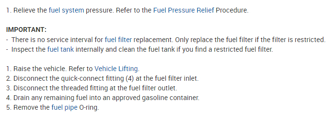

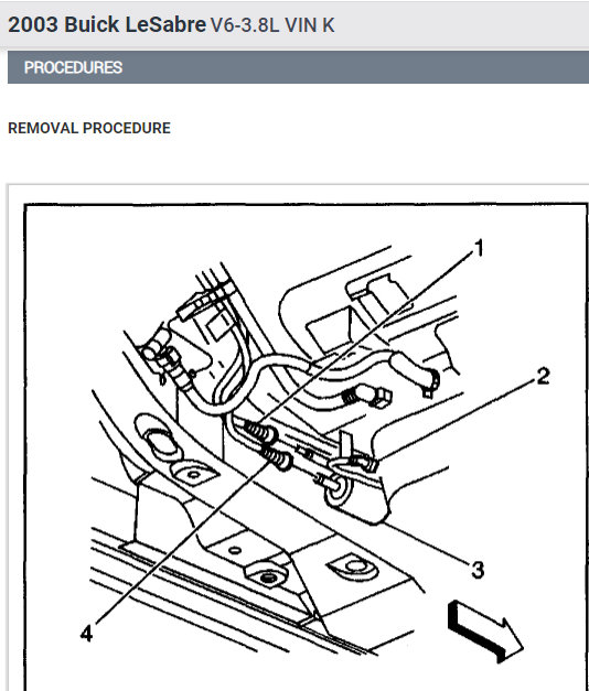

I would like information on the location and procedure to replace the fuel filter on my car
Saturday, September 20th, 2008 AT 11:28 AM
19 Replies
DANNY L
  • 5,648 POSTS
Hello, I'm Danny.

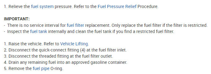

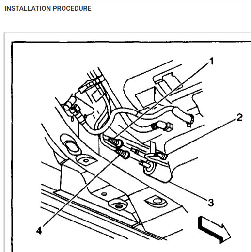

Here is the information you requested. This is a tutorial for you to view on how to replace a fuel filter:
https://www.2carpros.com/articles/how-to-change-a-fuel-filter
I've attached picture steps below for you on how to remove and replace the fuel filter on your vehicle. Hope this helps and thanks for using 2CarPros.

Fuel filter is on the frame, below vehicle, just forward of the gas tank, mounted in fuel line.
Disconnect the negative battery cable (MUCH better than removing fuse)
Relieve the fuel system pressure.
Twist the quick connector 1 / 4 turn in each direction to loosen any dirt that may have accumulated in the connector.
Use compressed air to remove any dirt in the connector.
Squeeze the plastic tabs of the male connector and pull apart.
Remove threaded connection from the filter inlet.
Remove the filter.

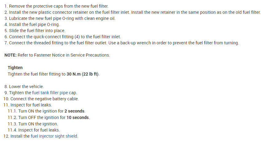

To install:
Position the fuel filter, making sure it is facing in the proper direction.
Attach the outlet quick connect line to the fuel filter as follows:
Step 1: Be sure the connector is clean and that a new plastic retainer is used on the filter.
Step 2: Apply a couple of drops of engine oil to the male pipe end of filter.
Step 3: Push the fuel line onto the fuel filter until the plastic retainer snaps into place.
Step 4: Check that the connector is locked into place by trying to pull the connector from the filter.
Install the threaded connection to the inlet side of filter and tighten to 22 ft. Lbs. (30 Nm).
Connect the negative battery cable.
Pressurize the fuel system by turning the ignition switch to the ON position for 2 seconds. Turn OFF the ignition switch for 10 seconds. Turn ON the ignition switch.
Check for fuel leaks.

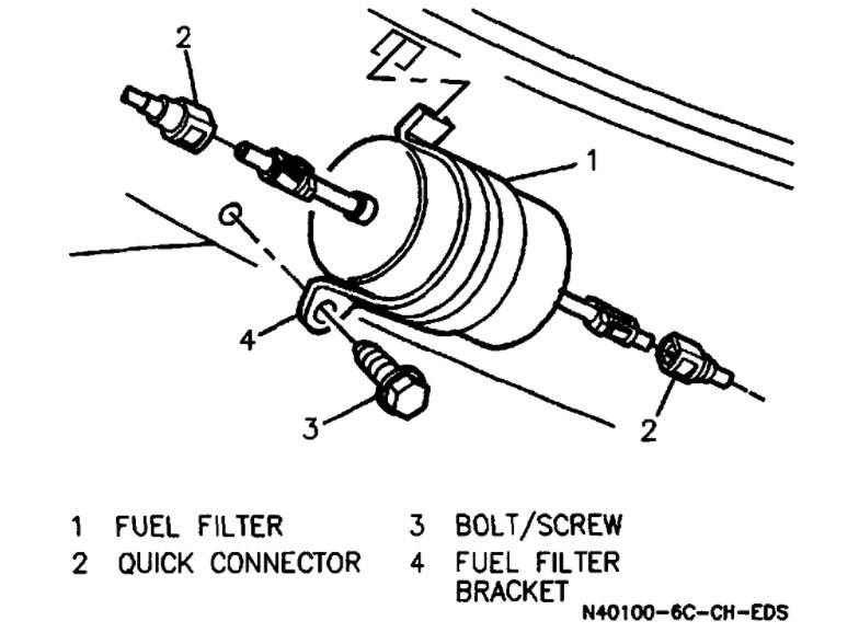

REMOVAL PROCEDURE
IMPORTANT: There is no service interval for in-line fuel filter replacement. Only replace the in-line fuel filter if it is restricted.
1. Relieve the fuel system pressure.
2. Raise the vehicle.
3. Remove the quick-connect fitting at the fuel feed line (2).
4. Remove the threaded connection (5) at in-line fuel filter.
5. Inspect the fuel lines, O-rings for cuts, swelling, cracks, and distortion. Replace the lines as required.
6. Inspect the fuel return line (3).
7. Inspect the fuel vent pipe (4).
8. Drain any remaining fuel into an approved gasoline container.
INSTALLATION PROCEDURE
NOTICE: Always re-attach the fuel lines and fuel filter with all original type fasteners and hardware. Do not repair sections of fuel pipes. If damaged, rep lace.
1. Remove the protective caps from the new in-line fuel filter.
2. Install the new plastic connector retainers on the in-line fuel filter inlet and outlet. Install the new plastic connector retainers in the same position as on the old in-line fuel filter.
3. Install the quick-connect fitting at the inlet of the in-line fuel filter.
4. Install the threaded connection at the in-line fuel filter.
5. Lower the vehicle.
6. Tighten the fuel tank filler pipe cap.
7. Install the negative battery cable.
- Turn the ignition switch ON for 2 seconds.
- Turn the ignition switch OFF for 10 seconds.
- Check for fuel leaks.

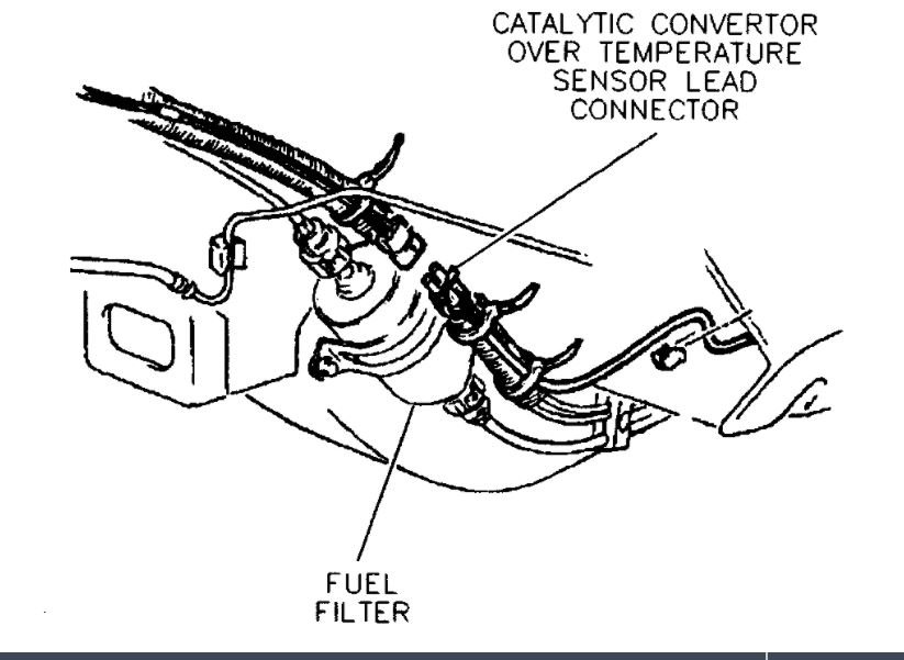

can anyone tell me were the fuel filter is located at on a 1992 buick lesabre I have looked everywere
Friday, February 19th, 2021 AT 7:29 PM (Merged)
  • 75,992 POSTS
The filter is located under the passenger side directly under the door area. The car will have to be jacked up to access it

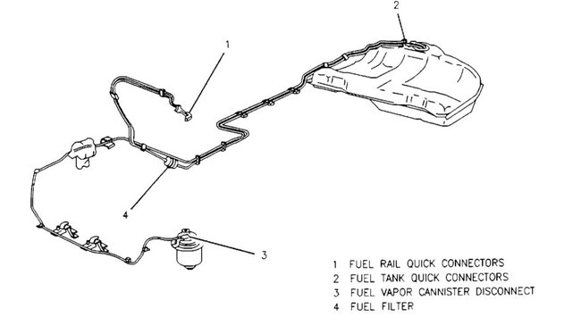

There are three possible locations for this component due to variation in production; under hood, passenger side, rear engine area, below firewall, mounted in fuel line OR under vehicle, passenger side, below seating area, mounted on frame in fuel line OR under vehicle, driver side, below rear seating area, mounted on frame in fuel line.
Thanks for using 2CarPros. Com!
