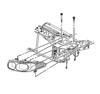

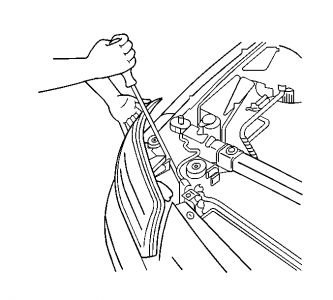

How do you gain access to the front side marker bulbs in order to replace the bulbs?
Jan 17, 2008 at 4:18 PM
DENNYP
  • 1,824 POSTS
Headlamp Replacement Removal Procedure Remove the headlamp fasteners. Using a pry bar, gently pry in the center area of the headlamp assembly. Pry the headlamp assembly straight forward in order to unsnap the headlamp ball stud from the ball stud socket. Slide the headlamp straight forward and disconnect the headlamp electrical connectors from the forward lamp wiring harness. Remove the headlamp from the vehicle.
