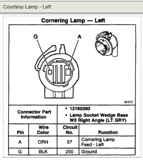

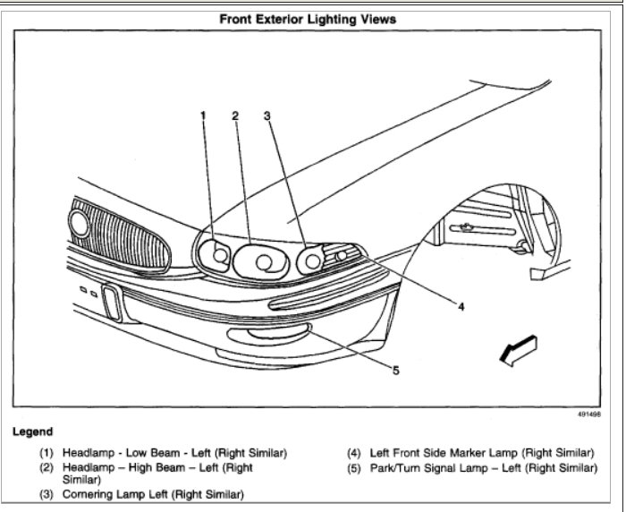

Can you explain how to change a bulb on my front left parking light? Does the lens pop out in front or is it an assembly underneath the front bumper that has to be removed? Thank you.
Jan 19, 2010 at 5:46 AM
  • 110,244 POSTS
You will need to jack the car up to get to the bulb from under the car you do not need to remove the bumper
and this will give you an idea on how to remove it
https://www.2carpros.com/articles/turn-signal-bulb-replacement
Here are some diagrams to help you see what you are doing (below)
