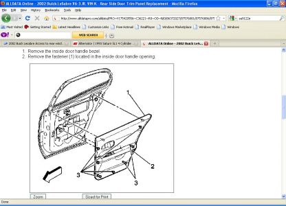

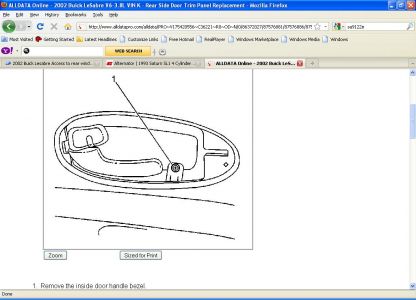

How do I remove the inside rear door panel to view the electrical window operating mechanism?

There you go.
