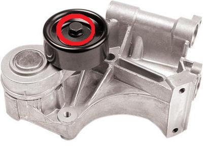

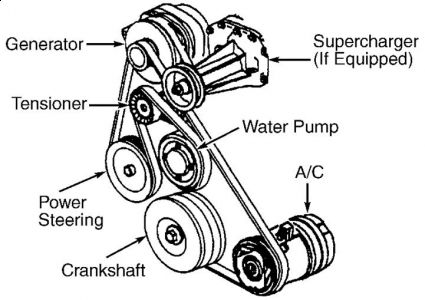

replacing serpentine belt it came off right nice,
but is there anything special to do to put it back on
thanks BUSTED KNUCKLES
Apr 13, 2009 at 3:05 PM
ZACKMAN
  • 4,202 POSTS
No special tool. Just attach an appropriate size socket into the tensioner pulley bolt and pull the tensioner assembly to loosen the tension.

and use this diagram to correctly install the new belt.
https://images.2carpros.com/forum/automotive_pictures/55316_02lesabrebelt2_1.jpg
