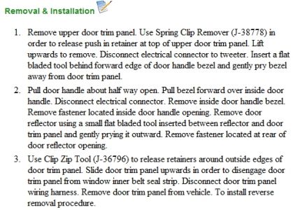

2001 Buick Lesabre 6 cyl Front Wheel Drive Automatic
window does not go up , motor runs, believe its the regulator, but I donnot know if the door panal has screws or does it just pops out. you this is not for me, but for 80 year old person who live a few house down. i donot want to start pulling if there are screws. sorry this is so long, but if you could answer this question, it will be great for this man. window stuck in down position.

https://images.2carpros.com/forum/automotive_pictures/261618_Noname_2271.jpg
