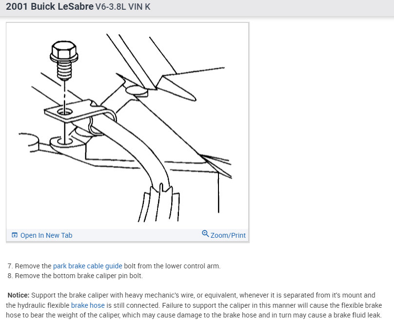

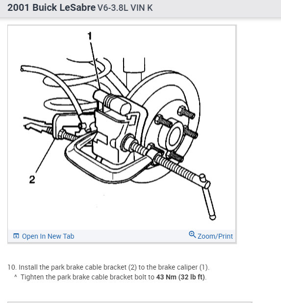

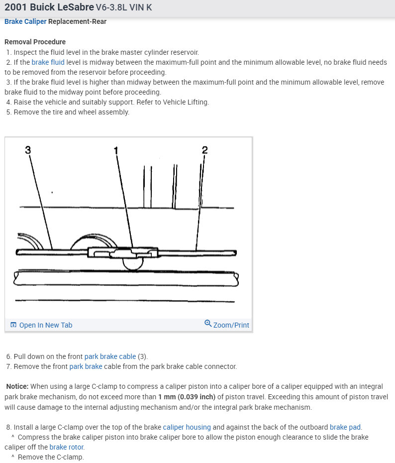

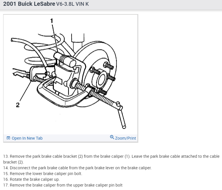

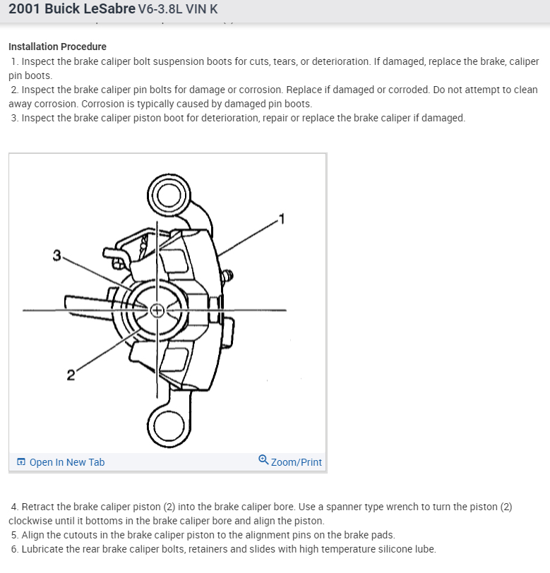

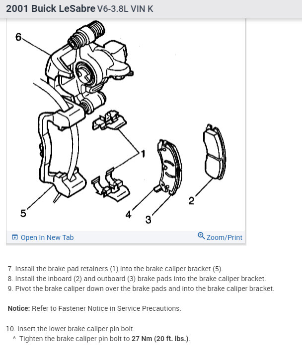

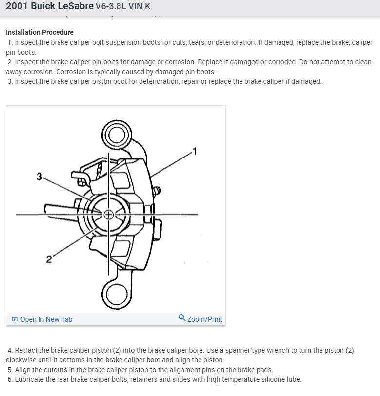

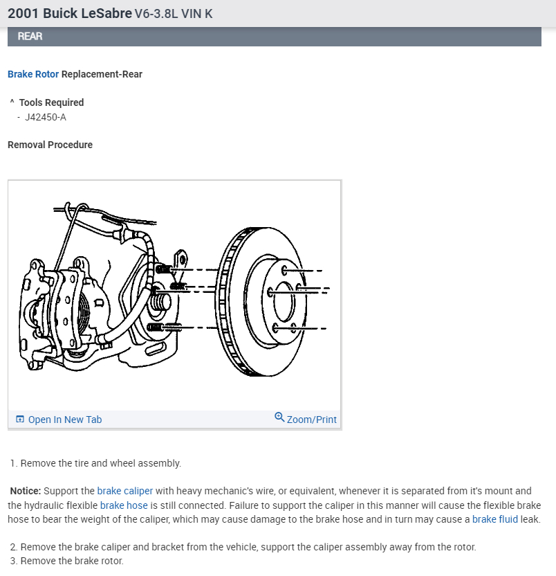

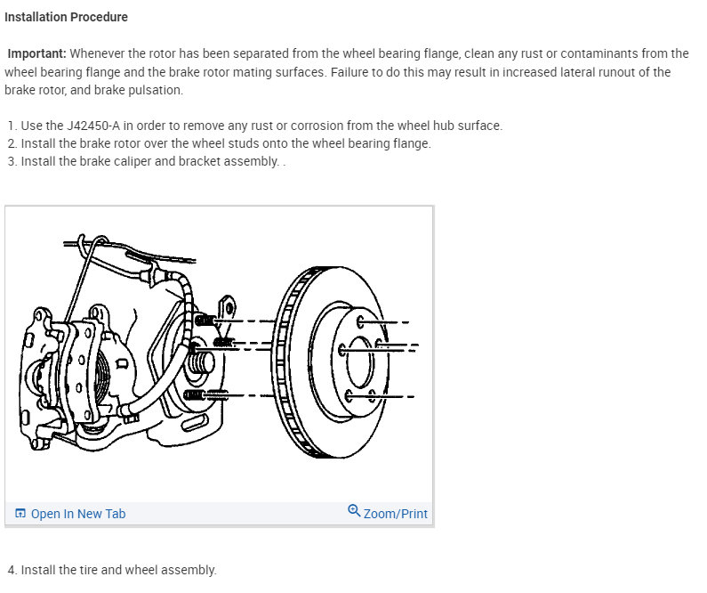

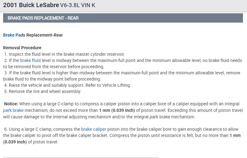

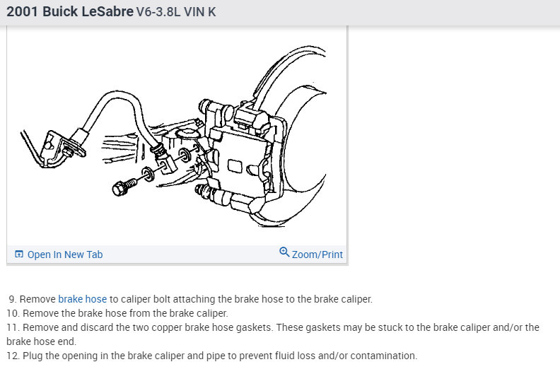

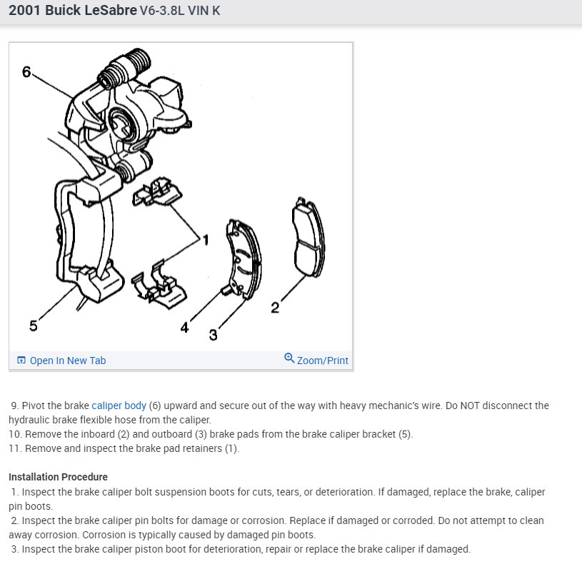

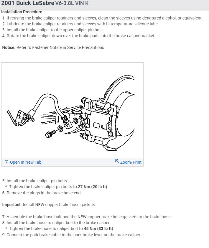

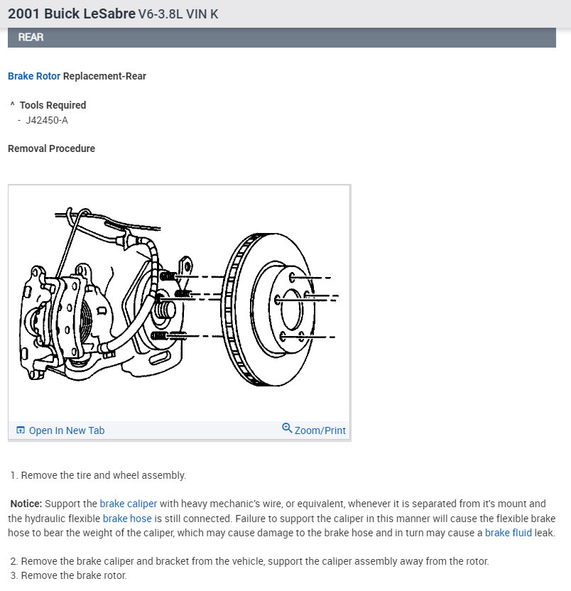

Should the calipers just slide off like on the front?
Sunday, February 8th, 2009 AT 12:15 PM
SQM
  • 6,383 POSTS

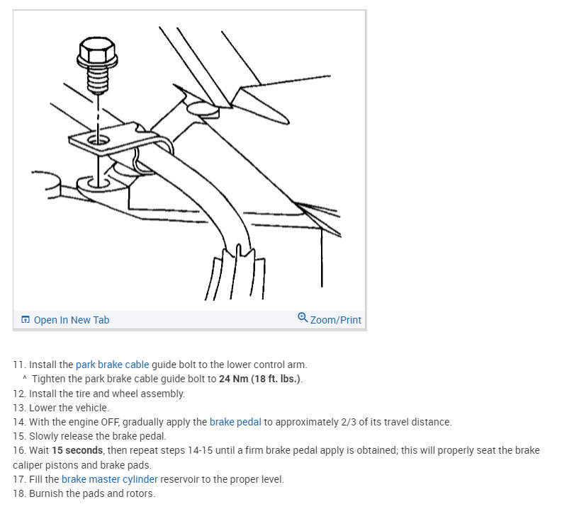

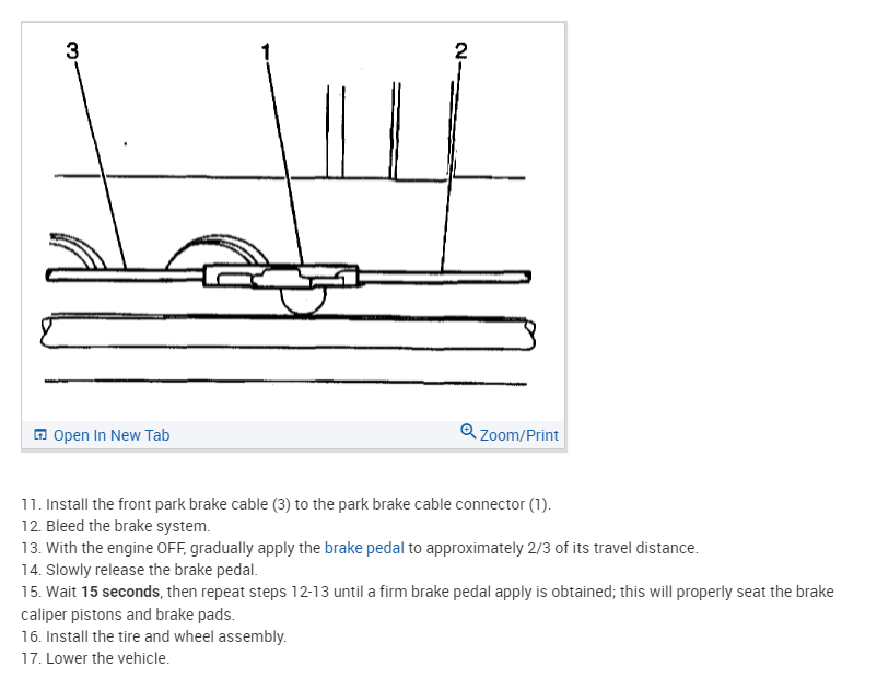

The rear calipers are removed similar to the front ones.
You will have to remove the mounting bolts and the brake hose, then the caliper will come out.
https://www.2carpros.com/articles/brake-caliper-replacement
https://www.2carpros.com/articles/how-to-replace-rear-brake-pads-and-rotors
I have attached the caliper replacement procedure as well as pads and rotor procedure for your reference.
