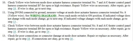

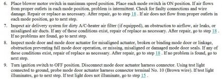

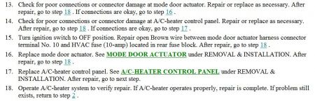

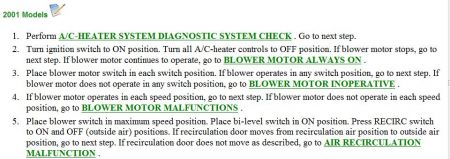

I recently brought my 2001 Buick Lesabre for service were spaks, oil, air filter, oil filter, rotors and brakes were replaced. As I drove back with the vehicle I noticed the the passenger side air conditioning cools very well. However, the two vents on the drivers side blow almost warm air. What the problem be?

Hi there, Thank you for the donation, Check through this check list for improper air delivery, i feel that it may help you with this problem.
