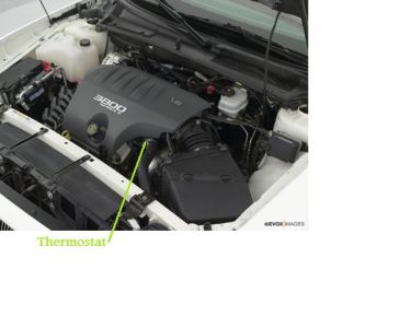

how do i change the thermostat on a2001 buick lasabre custom

Hi Steven, Your vehicle has nice easy location just under your engine cover. Two 10mm bolts are all that hold the thermostat housing down, and it even has a rubber gasket to seal. No need for scraping off the old one! You'll find the housing attached to the upper radiator hose on the engine side.
https://images.2carpros.com/forum/automotive_pictures/435113_thermostat_1.jpg
