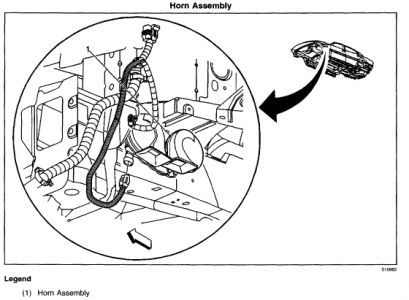

I need to replace the horn just not finding the location of it can you direct me to it please.
Sep 10, 2010 at 7:30 AM
  • 75,988 POSTS
https://images.2carpros.com/forum/automotive_pictures/12900_h_7.jpg
HORN REPLACEMENT REMOVAL PROCEDURE
https://images.2carpros.com/forum/automotive_pictures/12900_h1_20.jpg

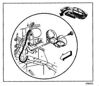

Remove the left front wheelhouse extension. Disconnect the electrical connector from the horn assembly. Remove the fastener securing the horn assembly to the left front frame rail. Remove the horn assembly. INSTALLATION PROCEDURE
Install the horn assembly to the left front frame rail. NOTE: Refer to Fastener Notice in Service Precautions. Install the horn assembly fastener. Tighten Tighten the fastener to 15 N.m (11 lb ft). Connect the electrical connector to the horn assembly. Install the left front wheelhouse extension. https://www.2carpros.com/kpages/auto_repair_manuals_alldata.htm
