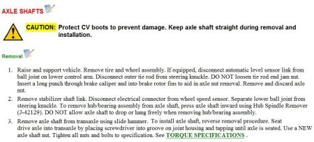

how do you replace the left half shaft

https://images.2carpros.com/forum/automotive_pictures/261618_Noname_2811.jpg

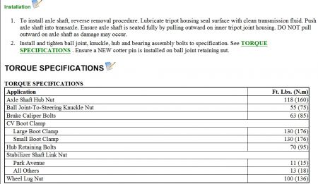

https://images.2carpros.com/forum/automotive_pictures/261618_Noname2_918.jpg
