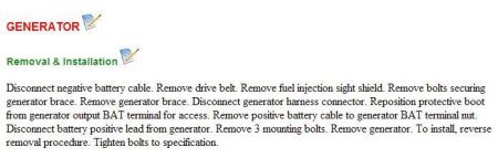

How do you replace the alternator on an 01 Buick Lesabre?
