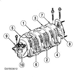

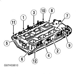

I am changing the lower and upper intake manifold gaskets what is the recommended torque for the bolts throughout the entire change
thank you
Tom
Thursday, March 18th, 2010 AT 7:21 AM
DOCFIXIT
MECHANIC
18,828 POSTS
If non supercgarged Lower torque 11 ft. lbs. Upper 89 in. lbs. see diagrams for torque sequence
