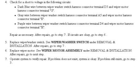

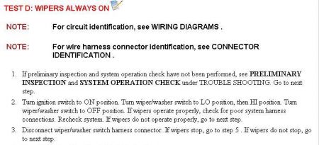

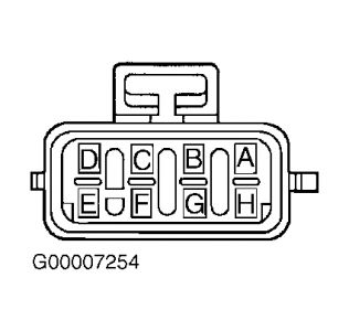

wipers won't tun off. when i turn them to the off position, the lowest intermitant speed is on.

https://images.2carpros.com/forum/automotive_pictures/55316_01centurywipertest1_1.jpg
https://images.2carpros.com/forum/automotive_pictures/55316_01centurywipertest2_1.jpg
https://images.2carpros.com/forum/automotive_pictures/55316_01centurywiperswitch_1.jpg

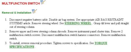

https://images.2carpros.com/forum/automotive_pictures/55316_01centurymulti_1.jpg

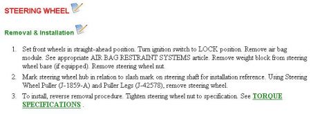

https://images.2carpros.com/forum/automotive_pictures/55316_01centurysteering_1.jpg

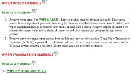

https://images.2carpros.com/forum/automotive_pictures/55316_01centurywipermotor_1.jpg

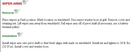

https://images.2carpros.com/forum/automotive_pictures/55316_01centurywiperarm_1.jpg
