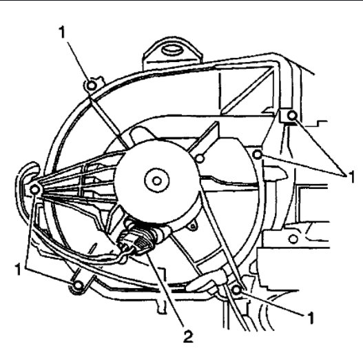

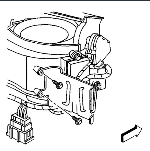

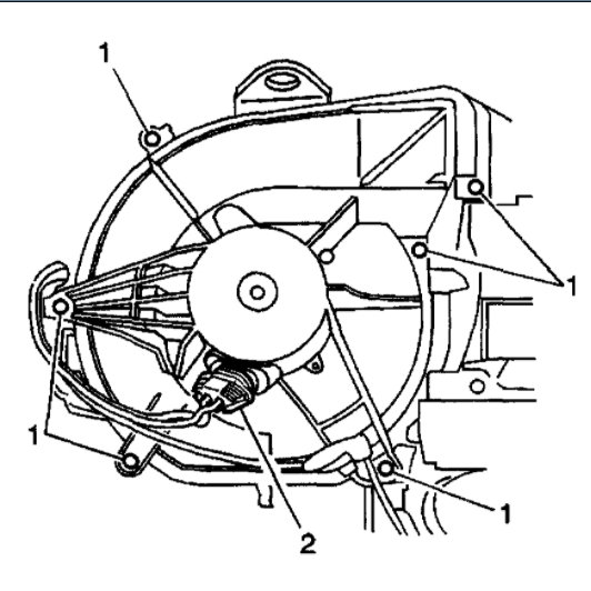

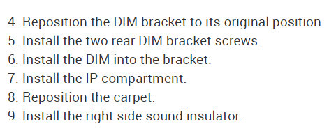

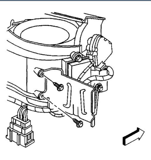

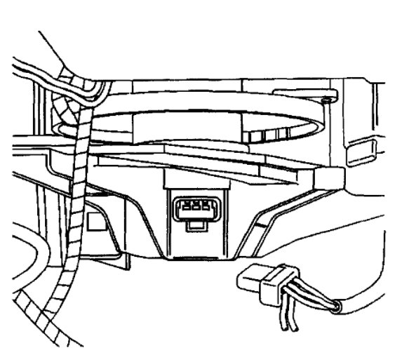

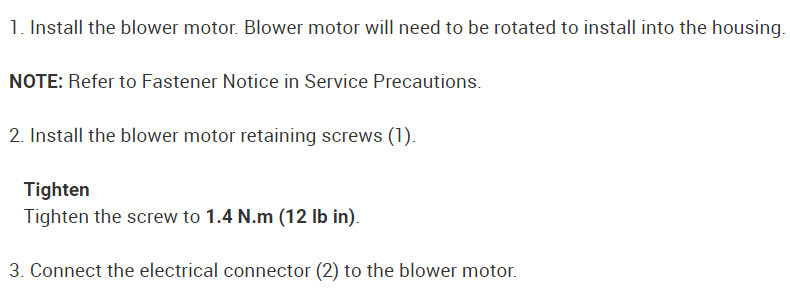

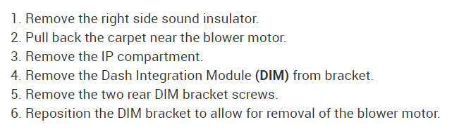

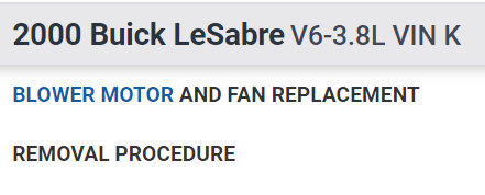

How do I replace the blower motor for the heater/air conditioner?
Sunday, June 29th, 2008 AT 2:52 PM
DANNY L
MECHANIC
5,648 POSTS
Hello, I'm Danny.
Here is the information you've requested. First, Here is a tutorial for you to view on how to replace a blower motor:
https://www.2carpros.com/articles/blower-fan-motor-works-on-high-speed-only
I've attached picture steps below on how to replace the blower motor in your car. Hope this helps and thanks for using 2CarPros.
