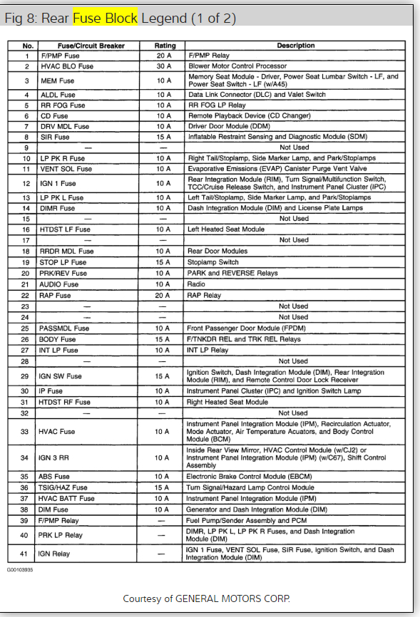

door locks not working
2000 BUICK LESABRE
GATEWAYBOI666
6 cyl Automatic 18,249 miles

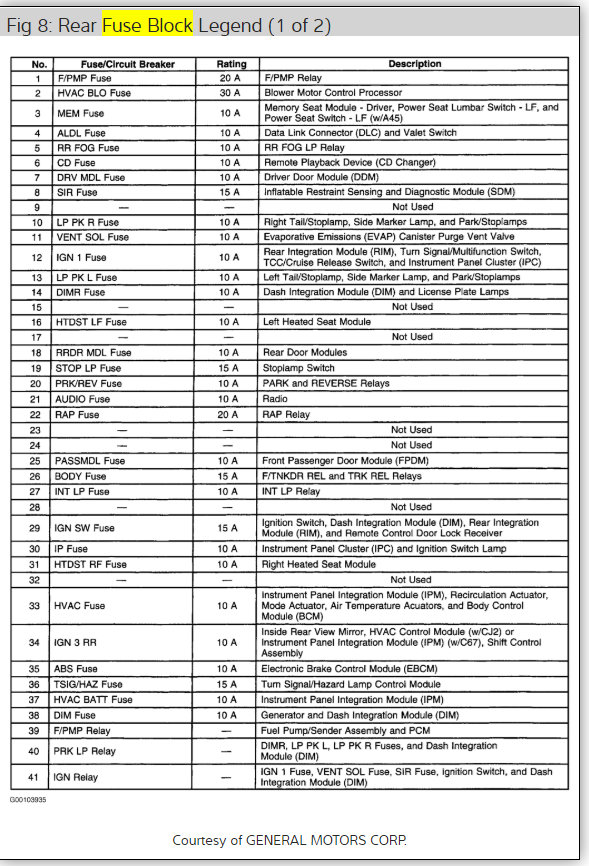

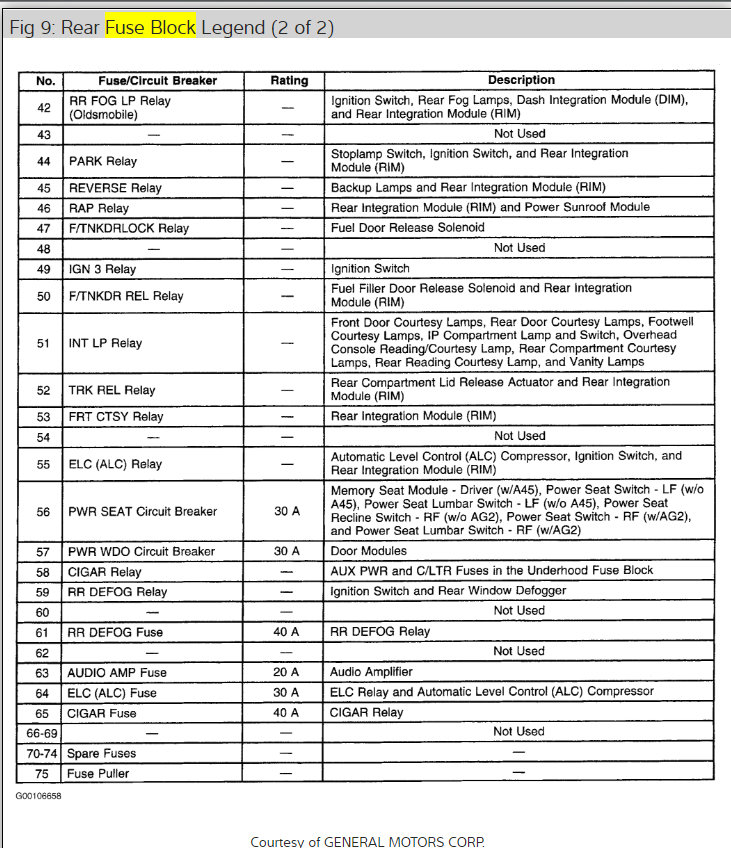

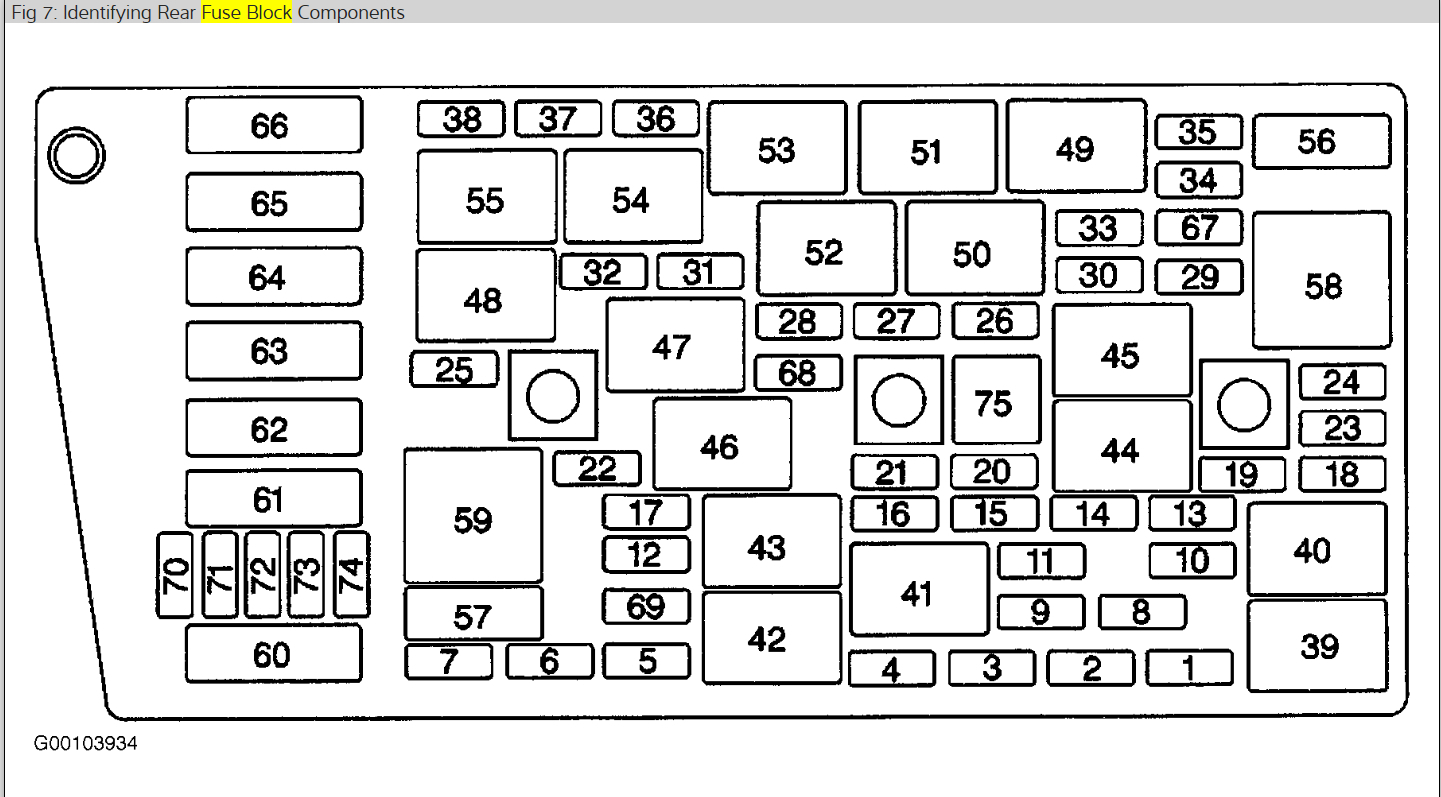

My buick lasabre suddenly went crazy on me. The interior lights and power locks went out, I have been to several places and the cannot figure out which fuse or relay switch controls it please help me.
Nov 12, 2008 at 9:48 AM
DAVE H
  • 13,384 POSTS
Here are the fuse panel locations and identifications with a guide to show you how to test the fuse #57 which is a circuit breaker.
Cheers
