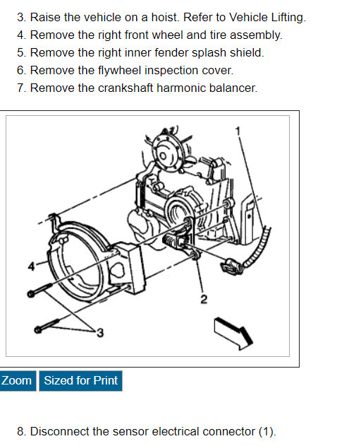

do you need a scan tool to do a learning procedure when doing a crankshaft sensor replacement?
Aug 24, 2009 at 3:29 AM
DOCFIXIT
  • 18,828 POSTS
No it should be okay, plug and play.
Here is a guide to help you see what you are in for when doing the job.
The crankshaft position system variation compensating values are stored in the PCM non-volatile memory after a learn procedure has been performed. If the actual crankshaft position system variation does not match the crankshaft position system variation compensating values stored in the PCM, DTC P0300 may set (refer to Diagnostic Aids for DTC P0300).
The Crankshaft Position System Variation Learn Procedure should be performed if any of the following conditions are true:
DTC P1336 is set.
The PCM has been replaced.
The engine has been replaced.
The crankshaft has been replaced.
The crankshaft harmonic balancer has been replaced.
The crankshaft position sensor has been replaced.
Cheers

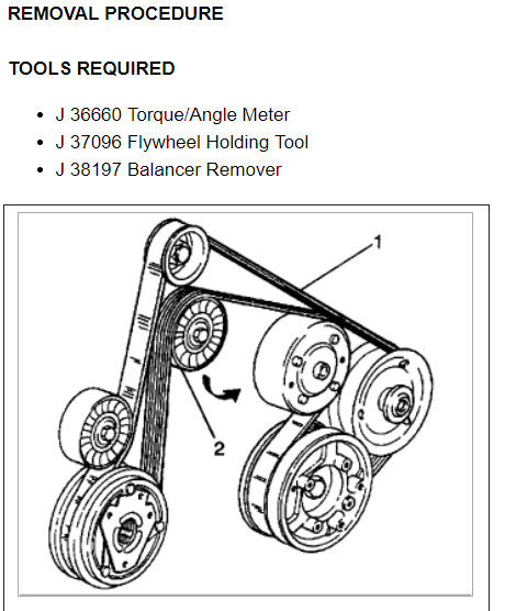

MICHAEL MARTINEZ
Do I have to take off harmonic balancer . I want the right tools to do the job
Dec 19, 2019 at 8:08 AM (Merged)
yes, you need a puller for the balancer. once that is off, it just unbolts.
why are you replacing it??
COINDOR4368
Bolt has been removed.The vibration damper is suppose to be able to come off by hand..But it will not move.I tried tapping with a hammer.There is no way to use a harmonic balance puller.(no bolt holes) Do you have any suggestions?
OBXAUTOMEDIC
  • 3,711 POSTS
Since it has most likely never been off and it doesn't matter what anyone or what a book might say, I haven't come across one that will just pull off... So what I do is take a pry bar and find a good place to get behind it and carefully pry it off alternating sides... It will most likely take a little work but will come off.

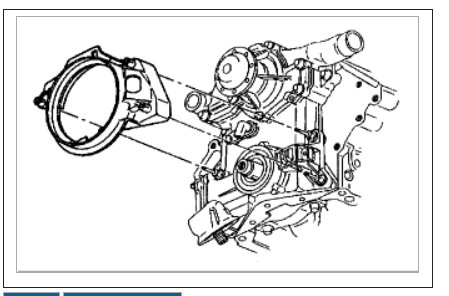

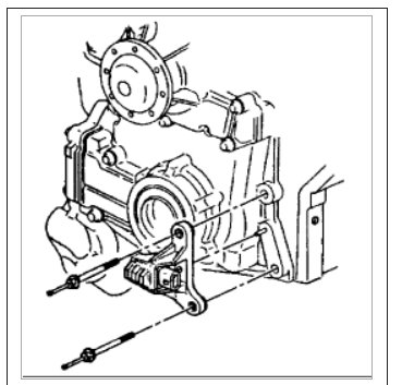

please tell me how to replace a crank position sensor on a 2000 buick lesabre
  • 110,240 POSTS
Hi:
The crank sensor is located under the harmonic balancer (the bottom pulley which comes from the engine). All you need to do is unplug the sensor, unbolt it and reverse the process with the new sensor.
If you have other questions or need additional help, let me know.
MESCOBAR
do i have to remove the harmonic balancer to replace the sensor
  • 110,240 POSTS
Hi:
No, you don't need to remove it. The sensor should be bolted to the block.
