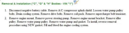

Any tips for replacing the water pump on a 1999 LeSabre 3.8?
